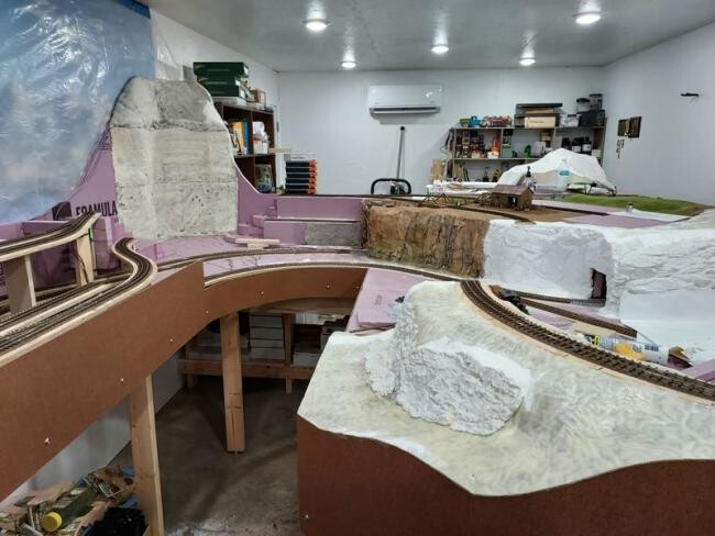

EmeryJ
May 2021
Lots of irons in the fire, but managed to get some more work done on the scenery. Slow but sure. This is going to be the elevated location for the Rail Road Camp. The last picture shows the beginning of a river that will flow along the track and under the entrance to the RR camp area. (no bridge built yet).

EmeryJ
August 2021
A bit more progress. Getting ready for the river and waterfall. The rocks have not been painted yet, just initial blackening of the recesses. I think I may try do some painting today. 3D printer is busy printing all the little fish that swim in the river. The grizzly bear fishing is ready to be painted too.
This month marks the first year since I started building the benchwork.
August 2021
Rock looks great, impressive.
Pappy
August 2021
Emeryl, looks fantastic!
Cant wait to see more or your progress.
I am jealous wishing I had more room to do this.
Robert.G
August 2021
Very good looking rocks !!!
admin
August 2021
What an awesome cliff. The detail and texture is fantastic. Cannot wait to see more!
KCSTrains
August 2021
Emeryl, I certainly miss having a layout. Your work looks great. Nice rock faces. Can’t wait to see the waterfall. Phil
Joel
August 2021
Love the cliffs.
