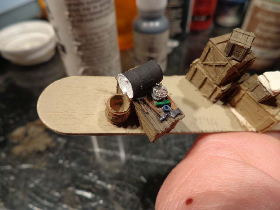

February 2014 edited February 2014
Finishing Off … yes already !!
I’m going to split this down into two or three posts, there is quite a few pictures to include and I get bored easily so I can take a quick break at various stages…
A little enhancement is required for the three barrels featured on the castings, now sure, they’re painted, nice and neat and a lot of times they would be left as is. However with next to no effort or time they can be elevated to the next level and really look good.
I will start by painting the tops white to give them some interest ( “holy cow, bright white?The guy talks about subtlety and things just keep getting brighter…” ).
The easiest way I find to do this with a nice clean sharp edge it as follows. Load a small brush up with the paint and starting in the middle of the top of the drum lightly draw it out and off the edge. Use as little pressure as possible so that the bristles don’t bend and come down the side to spoil the finish.
A few quick, light strokes from different angles is usually all it takes, depending on you base colour contrast you may need two light coats. Also remember that the top will be weathered and chalked so it really doesn’t need to be a perfect solid finish, too thick paint will spoil the finish.
When I had finished painting the barrels I wipped all the paint from the brush and dry brushed again the misc. clutter drawer and bucket for some extra highlights.
Once the white was dry I grabbed a jewelers screwdriver that was close by and added some relatively small scratches to the top of the drums.
I also added a few chips to the sides of the drums.
Time for some A&I…
I poured some A&I into a small container to work from (don’t ask me the ratio as I have no idea, the main jar has had ink or alcohol added to it as needed over the past 6 years. I guess it’s a medium strength in the scope of things..
I dip the small detail brush into the A&I checking that it is loaded but not dripping, then lightly touch an area of the casting where two items meet and I want to add a shadow or definition.
I worked all around the bench casting twice and a little extra here and there. Then moved on to the cabinet.
I’m just going to do the outside of this one to highlight the boards. I want to use a very small amount of A&I and have it run down the board joints.
Again having a wet brush (but not dripping) I hold the casting vertical and lightly touch the top of the joint. Thus allowing a small amount of A&I to run down the join but not so much that it runs down the face of the casting, quick and simple when you get the hang of it. If you do get too much A&I on the face and feel like it is too heavily done simply let it dry, re-evaluate the look and if necessary brush on some of the chalk (dry) that you used to colour the casting originally, this will mute or even obliterate the A&I.
Once pretty well dried I inverted the cabinet and repeated the process from the top edge running down.
Subtlety… Finally !!
Subtlety is one of the most important techniques (in my opinion) for creating realism in our models.
Whether the models are for the layout, the contest room, sharing with fellow modellers here on the forum or just personal enjoyment. Subtlety is a key ingredient.
I’m going to achieve this through the use of chalks, starting with the misc. junk drawer and bucket. Chalk colour is 411.3 and I’m using a small brush again.
Load the brush up with some of the dry chalk and dab it onto the areas for a rust finsh, I worked it down into the crevises.
A couple of light blows to remove all that excess chalk and the effect is really quite pleasing. Also notice how that subtle dry brushing is peeking through the rust… nice.
Next I finished up the oil drums.
Again I picked up some dry chalk with the brush and dabbed it where I wanted it. Concentrating primarily on the scratches, which is why the need for the small brush.
Again a light blow to remove the excess chalk.
As well as removing the excess chalk the blowing action in this case will give you a nice diffused rust effect, moving out from the scratches where the chalk was concentrated.
At that stage the white still looked too bright for me, so, I repeated the process once more to dull down the brightness.
I repeated the “dab and blow” process for the scratches/chips on the sides of the barrels.
Dab.
Blow.
The last thing to do was to dull down the other colours, the red, green etc and to dirty up those handles. For this I used my darkest wood shade, the 408.3. Using the small brush I specifically lightly dabbed this on the remaining items, and blew it off.
Moving onto the cabinet I stayed with the 408.3 as my dulling agent but stepped up to a slightly bigger brush as I’m not being too specific with this casting and just doing a general ‘dull down’ of the items on the shelves. Again using the dab and blow technique. Lightly dab the chalk onto the area to dull down, work it into the crevises, and blow it off.
Top shelf done.
Full interior done, I also used a little rust colour on the sideways black drum in the middle.
The final step was a quick dab and blow of rust colour on the door handle and hinges.
These two are ready for a diorama…

Black chalk, a force not to be taken lightly. This stuff is extremely strong in pigment and only needs to be used in very small amounts to get the desired effects. Too much and you could find yourself back tracking quicker than a Ferrari in reverse. But hey, now that I have put your mind at rest lets move on.
Instead of using the A&I for the shadows and definition this time I’m using the black chalk. Using the smallest brush I dip in the chalk (dry) and line the edge under the lip.
The excess is blown off. I repeated this under the lip on the sides also.
Next I moved onto the bench top itself. Again dipping into the dry chalk, shaking off any excess and then carefully adding the chalk along the edges of the cast in details. Very little chalk is needed and a fine pointed brush.
Any loose chalk was again blown off leaving a shadow effect around the items.
Hapy with the bench top I moved my attention down to the bottom of the casting where it would sit on the floor. I lined the perimeter where it would contact the ground and blew off the excess. Maybe simulating damp, or just grime or… whatever.
Whatever I was simulating it ended up a little too heavy a finish.
Using a clean brush I went to my 408.3 wood colour and blended it over the black, this toned down the effect nicely and I could move on.
Using a larger brush I used the dry 411.3 and dusted the oil drum main body lightly.
The tub of parts on the bench next to the oil drum and the scratched white face of the drum was given the “dab and blow” treatment on the scratches as before, and then a light dusting on the drum to tone it all down.
Finally using the small brush some black chalk was used around the spout to show a dusty, oily, messy finish.
I think that’s it for today.

Drums, barrels and crates.
Sure, we can all slap some red or blue paint on an oil drum, glue it down and call it done. However with a little basic work we can improve their look.
The castings were prepared as described earlier in the thread.
The small crates are attached to coffee stir sticks using carpet tape.
I place the crates on the tape at 45 degree angle. This allows me to paint all four sides and the top easily with no obstructions. I also use this method when doing benches, cabinets, shelves, etc.
The castings were spray primed as before, Khaki for the wood and black for the metal.
The base colours were then applied as described earlier.
Painting the bands on a drum is a relatively simple process utilizing the toothpick handle.
Carefully paint between the ridges while rotating the toothpick between your finger and thumb.
After the paint has dried, which may take two light coats for the white, you can clean up any overpainting with either a thumbnail or a toothpick by running it around the outside of the ridge. You should now have a relatively straight line of difference.
The top of the drum is painted as described earlier in the thread to get a nice clean edge.
I will generally work through all of the castings bringing them to the same point in the process.
Chips and scratches can now be added to these details to give them more interest and realism. I try to keep the scratches and chips small on items that are supposed to be in use.
As with many of the great techniques we learn from Brett’s incredible manuals overdoing the effect can sometimes spoil it and become a negative. Subtlety !
Scratches can be made with either a thumb nail, or maybe a toothpick…
Even a jewelers screwdriver or dull exacto blade. When using something sharp like this remember to use very little pressure, you only want to take off the coloured paint not the black base.
Again I will work through my selection of castings at one time. I find it easier to do the one process throughout while I have the tools in my hand, also repetition is good practice.
Now it is time to work on the wooden barrels with some chalk. This is now my preferred method for painting the bands on barrels. I gives a nice rust colour with a dusty dry rust textured look very easily.
We are using the 411.3 rust colour mixed with alcohol. This time we need to be a little more careful of our consistency, too much alcohol and the colour will flow too easily from the bands, which we obviously don’t want. A little practice is all it takes.
Also if a little of the chalk gets on the barrel it looks like the rust is leaching into the wood and not like a sloppy paint job.
If you wander too far off the band it can be removed with a tooth pick or covered back over with the original barrel colour.
As with the oil drum the toothpick handle makes a simple job of rotating the barrel while carefully painting the bands with the C&A. I complete one band all around before moving to the next.
The finished item.
We will stay with the 411.3 rust colour for the effects on the oil drums and tanks.
This time however we will be using the chalks dry.
We will once again be using the “dab & blow” method from earlier.
Dip a small dry detail brush into the dry chalk and lightly dab it onto the casting, do this specifically over chips and scratches.
Lightly blow the excess chalk from the casting. Where the chips and scratches are the black base will show darker through the remaining chalk, thereby looking like old exposed rusted metal. The diffused chalk left on the paint will look more like surface rust and rust coming out through the paint.
That’s my theory anyway and I’m sticking to it.
Repeat the process on the other items you have ready and waiting.
Sometimes all you need to do with an oil drum is prime it flat black and using a slightly bigger soft brush dust on some chalk. One or two of these abandoned out of the way on a dio also look great.
Wooden crates in the next post.
Wooden Crates.
The wooden crates were primed as shown earlier with the Khaki colour and then coloured randomly with the three shades of chalk.
To enhance them a little I give them a light dry brushing with the ‘sandstone’ and then a dip in the A&I.
In my own personal modeling I really do very little dry brushing unless it is for a specific reason or item. Some like to dry brush everything. It’s a personal taste thing I guess. For me there is a time and a place.
Regardless of that here is how I do it…
I’ll dip the end of the brush into the paint picking up just a little.
I will then rub as much of this off as I can into an old rag, generally in a circular motion. This will do two things, it will remove the paint from the outside of the bristles, it will also work the paint up between the bristles into the center of the brush, kind of like a reservoir.
Once I think I have removed enough paint I will run the brush over the back of my hand to test. Usually there is more paint than I thought and I remove some more and test again.
Once happy with the amount of paint being released I lightly brush the casting at 45 degrees to the grain or ridge that I want to highlight. Lightly brushing will build up the highlight. The beauty of the chalk base is that if you add a little too much paint a quick rub with a fingertip will blend it into the chalk base.
When happy with the dry brushing I will give the castings a quick dip in A&I. I don’t do this for all of them just a random selection.
My A&I is in a pickle jar, it’s great for staining 8" lengths of O scale stripwood quickly, the jar is about half full. I’ll just add alcohol or ink as needed based on the results or level in the jar.
Shake up the jar to get an even mix, then I quite simply grab a stick of castings, dip them in the jar and swirl them around, shake off the excess A&I and put the stick on a rag to dry. The castings in the white circle were not submerged, for a slight contrast in finish.
After about 10 minutes the castings were dry and ready for placement in the scene.
I’ll post a group shot tomorrow of the details we have worked on and finished throughout the thread.
I hope this thread has been beneficial to some of you out there following along and I look forward to seeing some of your results.
