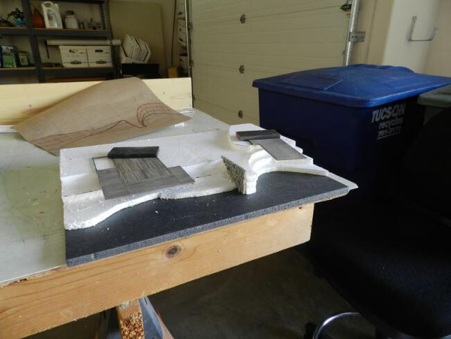

I have started the diorama base. The first step was to draw a template of the area with the layout of the wharves and the land formation.
I then used carbon paper and a pin wheel to transfer the land formation to the 1/2" sheets of Styrofoam.
I then cut out the different Styrofoam sheets.
I used a 1/2" piece of Gator Board for the base, and then used a caulking to glue the base and 4 layers of Styrofoam together.
I then placed the wharves where they are supposed to appear on the diorama.
March 2017
Looking great Steve. Colouring on the wharf decking boards is nice and sun bleached with great variational tones.
The land forms are also looking good, I loved this stage of the build.
As a side note, if you find the caulked together layers are taking too long to dry and are still sliding around and not firm, but, you are keen to move on… push toothpicks through the layers at 45 from several directions, 10-15 should work well for you, just snip off the excess with some clippers/nipers. This will prevent the layers moving while the adhesive is still not set and allow you to move forward if you wish.
sdrees
March 2017
thanks Karl. So far I haven’t had any problem with the Styrofoam layers sliding around.
March 2017 edited March 2017
Good to hear, caulk is nice and tacky, other adhesives not so much and drying time can be extended due to lack of air. I always was impatient… ha

March 2017
Really good start on the dio base Stephen. I love the topography that’s built into the Shelby’s diorama, Brett did a marvelous job with the design.
sdrees
March 2017
Thanks Ken, I hope it turns out as well as the rest of the diorama.

I am getting closer to pouring the water. I have been working on some of the landscape for the diorama and just about finished. I made the tree from sage brush as the armatures, polyfiber and course turf. The grass that you see is the static grass. The boom truck was kit bashed from a Sylvan kit.

Thanks everybody for the nice comments. It finally is coming together. Now to pour the water.

For the water, I painted the gator board base in various blue green tones at the beginning of the project. Once almost everything was complete I then built a dam around the front edge of the diorama using first masking tape, then strips of Strathmore board which I glued to the edge of the gator board. I then brushed on a thin coat of Evirotex to seal the dam useing Envirotex Lite and I also caulked some areas where it looked like leaks may occur. I poured it in 3 different layers about 1/8" thick. I then used a brush to stipple the Mod Podge on to add the texture to the Envirotex. As a final coat, I brushed on a water base varnish.
